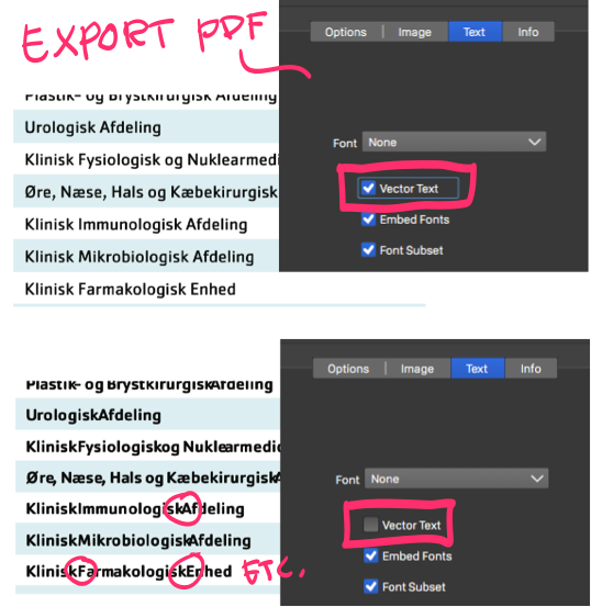

VS has improved handling pdf-export (I feel), but there is still serious problems.
It's not optimal – when exporting pdf's – selectable text information must be switched off (Vector Text selected) for acceptable typography.
0_1710689456820_fejl-pdf-vektor-tekst.zip

I opened the attached PDF files in both Preview and Adobe Acrobat and it seems to render the glyphs correctly:

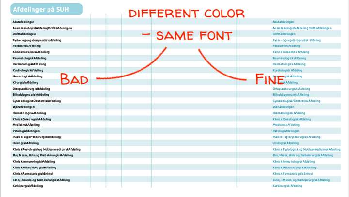

"Driftsafdeling" (as you'll notice) does not at all seems to render acceptable ...Though "0_1710747540045_exportfont1.pdf" seems fine.
Also I can't figure out why the difference (aside color) since it's identical font. Do you have any idea?
@Raaskot I will try to find out what could cause this.
@Raaskot Can you send me a PDF exported from VS where the different color with same font is broken.
I think this might also be dependent on font type, and I do not have the exact same font.
I'll send files on email ...
@Raaskot The problem can be replicated here also. The fix will be in the next build.
This issue should be fixed in build 1.2.019
