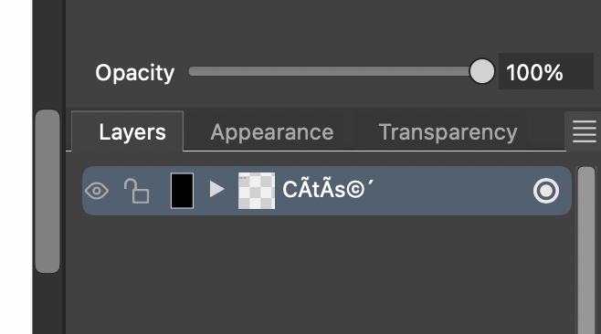

I dont know if it's related to this topic but I cannot rename layers in the layer panel with text containing French marks/accents (such as é, è, â...). While I type a character it displays the right letter then substitute it to another one when I write the following letter. Here's the result of the word côtés (sides) :
No problem in the text in VS files though. So it's not a big deal. I tried to change the interface font but the problem persisted.
@Devil-Dinosaur I opened a bug on this, and will try to fix it for the next build.
Works fine on 1.2.018
Thank you for the quick fix
