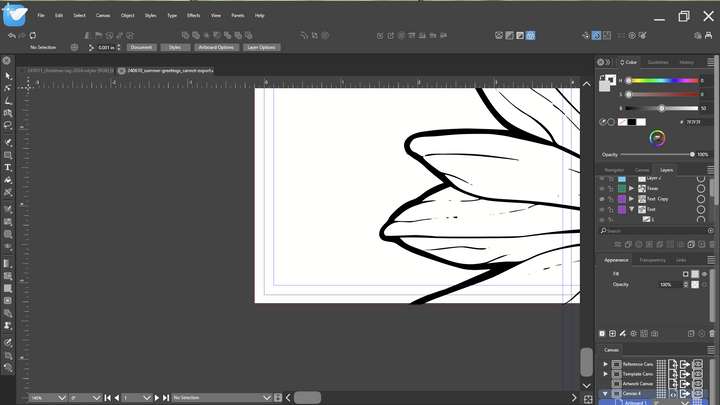

A consistent trigger on my machine is when my monitors go to sleep and I wake my computer out of idle. I have 3 displays hooked up at the moment and the HDMI monitor waking up later always moves my Screen 1 applications to Screen 2 (HDMI is Screen 3) and it ALWAYS messes up VS.
Right now when it does this, it does a thing where it has the min/maximize buttons only showing a grey background and nothing else. That is all that is visible and it's just in the corner by itself with everything else running on that screen completely visible. If I try to move the VS window in-between monitors using Windows Key + Shift + left/right arrow when it is in this state, it completely ignores Windows Key snapping commands.
I did manage to get it to come back by using Snapping by right-clicking on the VS instance and selecting Snap Left/Right, but it only worked once. It was usable, but in a janky state with some interface elements were overized and weird gaps appearing in places there weren't before... such as above the docked document window... but at least the interface was in the right order... I had to close and reopen it to get it back to normal.
Edit: Oh hey, it's back... I went to adjust resolution on Screen 2 and VS moved itself from Screen 2 to 3 (that's a Windows 10 quirk, not VS)... but yeah this is what it looks like if you can get it to appear... :
@debraspicher I will try to replicate this.
@VectorStyler I added a screenshot to the report. I got VS to restore itself.

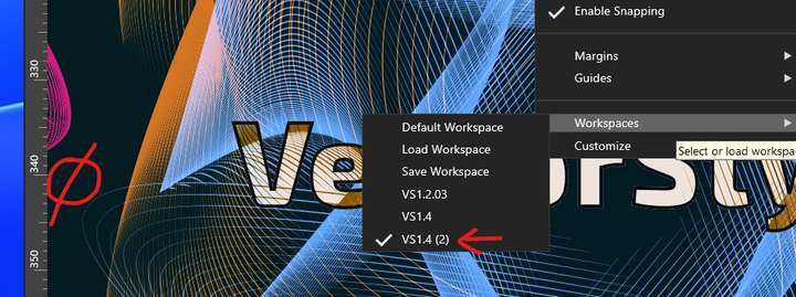

@VectorStyler Although VS indicates that a workspace is selected, I'm missing the tools panel and other panels... I don't know if that happens on Mac but on W, this is a recurring and fairly frequent issue (for me). Do I have to delete all ws and repeat creating them again ?

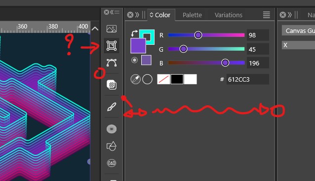

@VectorStyler There are still quite a few issues with the UI. Clicking on an icon doesn't open the panel, it's impossible to enlarge the width of a panels column, or trying to adjust the width of an intermediate column changes the width of the one on the far right...
@B-Vs-V The iconified panel column width can be resized (to show the name). I have to replicate the icon not opening issue.
