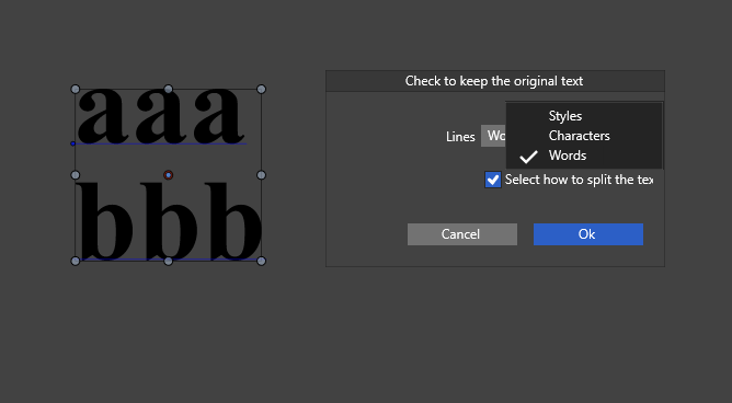

Splitting text into lines is impossible
The splitting into lines disappeared after the lastest update.

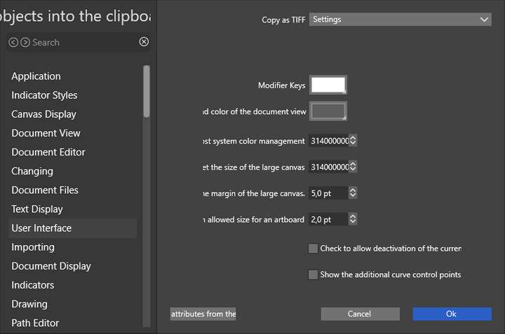

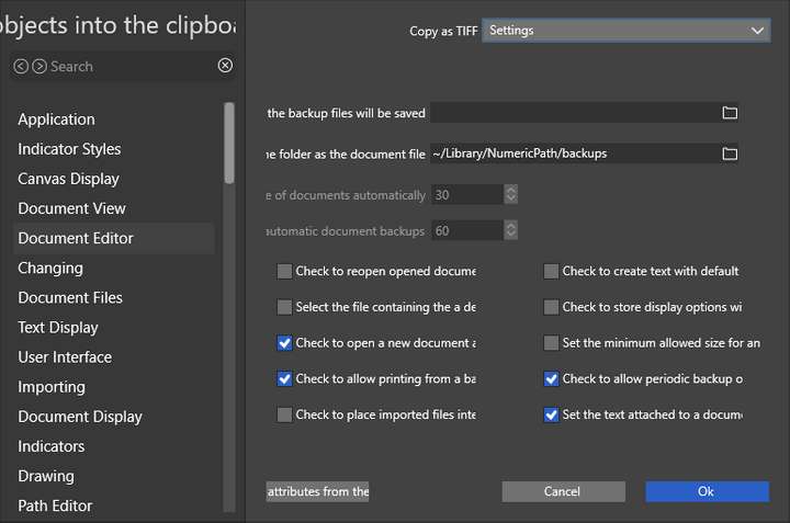

@encart There might be a problem with the resources. All resources in that view are shifted.

@VectorStyler I have followed your list step by step. Only the last one made the problems disappear. The problem with the interface occurred in many places.
