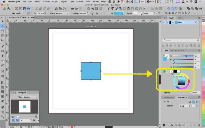

What I need now is a shortcut for [Remove color]. That is to correspond to the tip at the bottom of the color panel.
In my previous statement I misspelled "non fill".I see no need to change the role of the other tips right now.
First: Remove color
2nd: black
Third: whiteThe examples are only for Adobe products.
1st: Color
Second: Gradient
Third: no colorThe Adobe formula is not necessarily the best. However, it is based on the assumption that many people are familiar with it.

What I meant by "tip" is correctly "button".What I need is a shortcut to [ remove color button ] or its menu command.
Arrangement of buttons
Function of buttons
These are as they are now.The reason these three buttons are different from Adobe products is that the developers have not yet reached a conclusion.
For example, there are unresolved issues such as what kind of typicality should be derived for gradients.
