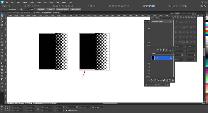

 Version 025, you wanted to solve the first problem, but because the problem could not be reproduced, the problem in this version still exists. You solved the problem that the size of the image dragged out of the link panel does not match the actual size. But as a result, a new problem arose, that is, the image dragged out will have a 1-2 pixel black border, and the image cannot be filled with color. The halftone Tif is not a hollow state. In version 026, I didn't download it and directly updated to version 027. In this version, there is a surprise. The first problem has been solved unconsciously. So now the problem is that black border. Please find the reason. Thank you.
I will try to replicate this problem.
