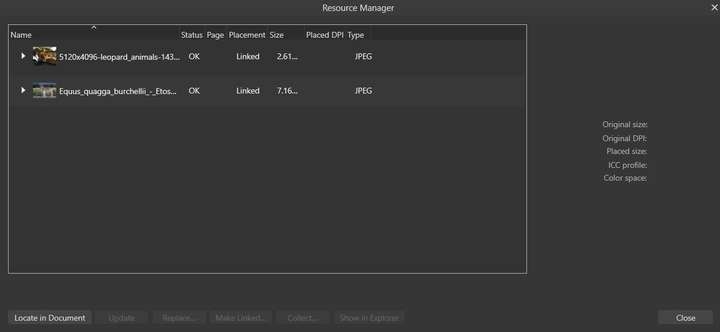

Working with multiple instances of a linked image, I cannot replace a single instance with a different image when using the Links panel? I am only able to do this when I have Interactive Import Place disabled, but then I love this setting…

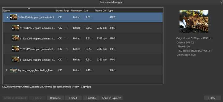

Affinity’s Resource Manager is remarkable in how it handles this dilemma. Note how it populates all similar instances of an image under one container? Adobe InDesign also has a similar solution. With this solution one can effortlessly replace single or multiple image instances using the Links panel/Resource Manager.
Also note how the Replace image function has been incorporated in InDesign (in the Place dialog box and Relink button on the Links panel).
