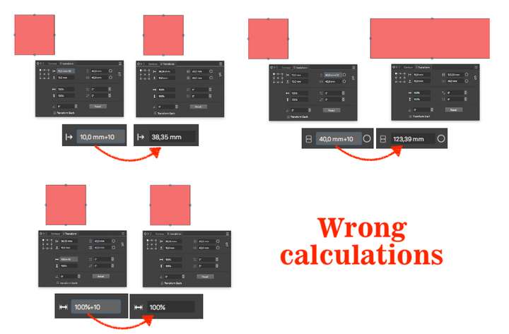

When adding calculations tol number field it returns wrong figures. Appears very odd.
A bug?
@Raaskot it might be a bug in the way that "mm" is interpreted. Try without the "mm" part. I added this to the backlog.
Affirmative. Works by eliminating the units. Also goes for "%"-box.
