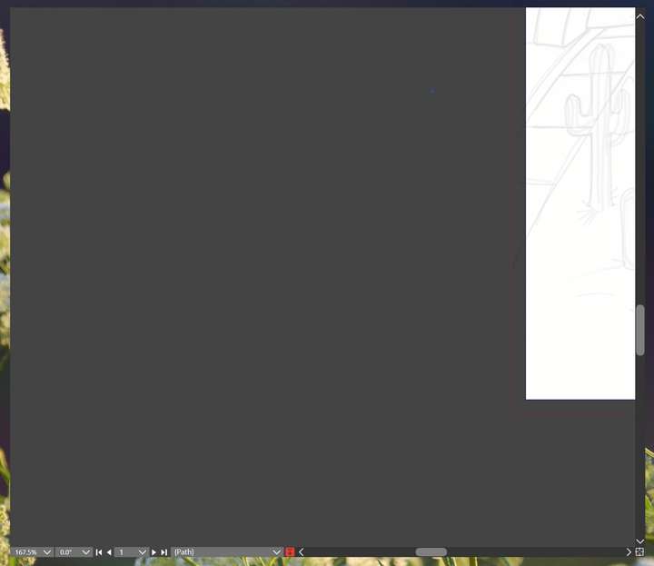

    I did check the demaximized behavior and was able to pull out the window normally. That window still has a menu, though I'm not sure if that is normal. I was able to change it to "Single Document View", but I did manage to "break" that window though by using Ctrl/Alt + Enter. (Standard key combination for leaving/entering full screen in Windows)
    It is resizable, but looks like this now:
    I wasn't able to reproduce it on video, but did some testing:
    1. The menu doesn't show immediately when pulling the panel, at least on my setup
    2. There's other odd UI glitches/oddities. When trying to click + drag the panel, there's dead space, but then another click I'm able to move things. This occurs frequently on Windows with various different panels/UI.
    3. I'm not real sure if I should be able to immediately click and drag (to pan document) when activating the window, because it does seem to require a double click. Often the UI seems halfway in focus and requires extra clicks to get things back into full control of the user. All of this is with the mouse rather than a tablet:
    https://1drv.ms/v/s!AuWHX0h5bAoRifx1-bDGiqNV2_WBtg?e=yDLh95
