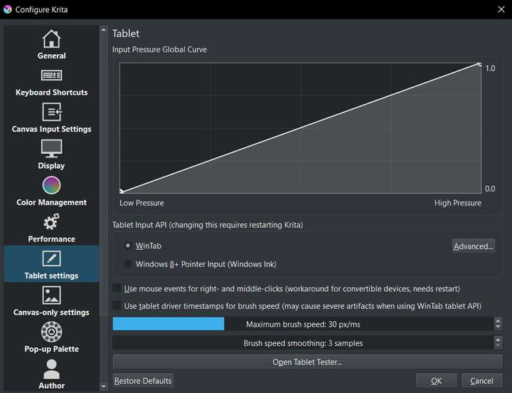

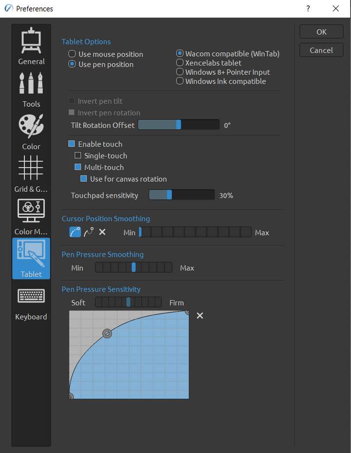

I've checked Krita, Rebelle and Illustrator and the pen pressure works great without Windows Ink. They're using WinTab driver:
Krita
Rebelle:
