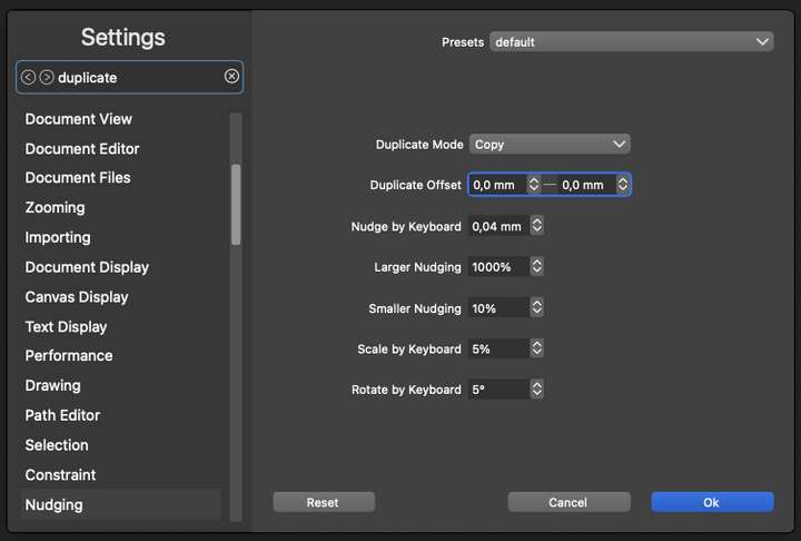

@Ingolf Seriously, thank you! I have no idea how that got changed. Might've moved when I was checking through options on the above setting.

There is a default offset in the app configuration file that is part of the VS install.

As he says, this is the default in VectorStyler, likely inspired (perhaps a bit too much) by Adobe Illustrator. The intention is probably to make it easier to see and select the new object in relation to the original. It disrupts my workflow significantly, and I find this behavior outdated, likely stemming from a bygone era. The world has duplicated billions of objects since this "helpful" feature was conceived. It is clearly evident in the layers panel on our high-resolution screens that we have added extra objects.
In any case, I use duplicate most of the time to create an object I need to move horizontally or vertically a certain distance aligned precisely with the original, so I quickly disabled this behavior. The idea of duplicate is to create a copy faster than copy-paste, so placing objects somewhere I have to move them away from creates more work than copy-paste. For me.
Personally, I think this is a behavior and setting that could be removed entirely to make the program easier to use and the preferences slightly less cluttered.
