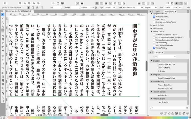

The mojikumi sample is ready. However, there were some obstacles that prevented me from starting work. Also, I manually trimmed the parts of VS where the corresponding function was not normal.a) Japanese input cannot be performed normally
b) Some system fonts are not recognized.
c) Character and paragraph styles do not work together correctly for reasons b)Avoiding problems b) and c) with vendor fonts improved style coordination. Then I started working.
The body of the text was assembled very neatly.
Skill was required for "ruby", "emphasis mark", and "warichū" processing. I will continue to examine and report on these in more detail.
Especially, "ruby" and "character set" are complicated. It will be difficult to complete with Ver1. As long as the basics of these functions are established, I think that it should be improved by version upgrade.
I also found that these processes could be replaced by VS's "individual characters tool (Shift + T)".VS Ver1 will implement features that Illustrator has put on hold for "more than 30 years." It may be a dream only for Asians, but I am very grateful for the enthusiasm of the developers.

Report on the following items (ver.1.0.027)
x) Japanese conversion bug
a) tate-chu-yoko
b) kenten
c) shatai
d) ruby
e) warichuf) mojikumi
g) kinsokuMaterial data (up to cloud)
-Input bug: mov
-Document: VSx)
issue: Blanks are entered when using the input mode selection keys (eiji, kana).
Corrective action: It should be corrected so that blanks are not input when switching the input mode. (Cf. Mov)
Other previous issues have been fixed.a)
issue: A little space appears on the characters.
Isn't the origin of the alphabet aligned with the full-width frame?
First-aid measures: Shift up to about 200/1000 and resolve.b)
Unfinished, but durable for general use.
issue: The default character is not partially reproduced. Dot, Fill Circle, Lozenge
Character input does not fully support Japanese "itaiji".
It's a feature that isn't used often, so I think it's better to mature it over time.c)
Horizontal composition: adjust rotation has been fixed.
Almost completedd)
Generally good.
groupe> center: As a graphic application, it would be great if this could be done. After that, I think that it should be aged over time.Items to consider: Need to visualize the subsumption relationship of nested setting items.
Inclusive relation display of nest items such as Font and Size is not implemented.
I want you to be able to see it.
When Rubi is set in VS, if "Arial" is displayed in the dialog, it will be ignored if it is set to HugenoMin in character style.In InDesign, inherited items are displayed as horizontal bars or blanks.
Ideally it should be like this.This issue is the same for kenten.
e)
issue: Horizontal composition; Aligned with the European baseline. It appears to shift above the full-width center.f), g)
Incomplete but working fine. I think it would be good to take time to complete the aging.
