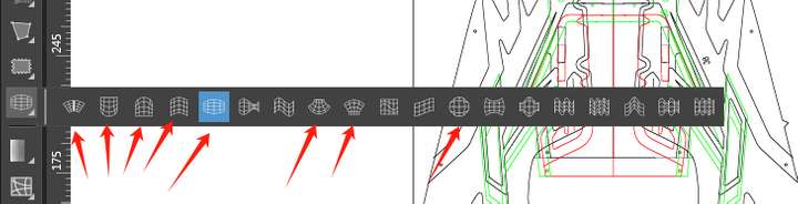

  The first row should be the ones that most people use more, but many of them are not supported. I hope they all can be added. The red arrow in the second row is the one that I personally use more, and some of them can, while some can't. I hope to add them. Also, can the tools in the second row be added with direction keys to fine-tune the control points?
@monsterfox I will try to add these.
