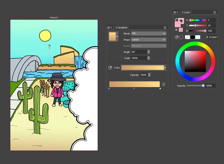

I have another video with other possibly new bugs. A few issues (mostly in order):
I can't edit the node positioning, however occasionally it will drop random (new) positions.
At about @0:06 in the video I go to activate the second node to remove it and it both removes itself and creates a new swatch in the middle. This creates a Cyan swatch in the center. This is interesting because this swatch was used in the Sky Object above it and was one of the last swatches I worked with before moving to this Object. It could also be that I activated the Sky wrongly and then went to select the Ground object and it remembered this selection. It did let me delete that swatch, but I had a lot of trouble deleting others. Either way, I lost my original color scheme upon deleition, so I had to undo.
There is a point where I can haphazardly create other Cyan swatches in the middle portions of the Gradient, but I can't activate those to work with them.
The swatches themselves are difficult to find and click due to the percentage label overlapping them.
Note also, the percentage labels are appearing at strange locations and in some cases are delayed in following the mouse as I drag. (The red circle indicators when I'm clicking or dragging with the mouse). Sometimes when I click, the percentage label would be offset a bit, but it's harder to see in the video.
Periodically the cyan swatch likes to remake itself and apply itself to the center. The Cyan swatch is probably a leftover from working with the Sky object before this one, but why it would remember that swatch and try to apply it here, I'm not really sure. I could've selected the Sky Object right before starting this gradient and it may have been kept it from then.
Link: https://1drv.ms/v/s!AuWHX0h5bAoRipIZ-wPKfBK_8JiiuA?e=xLIrMt

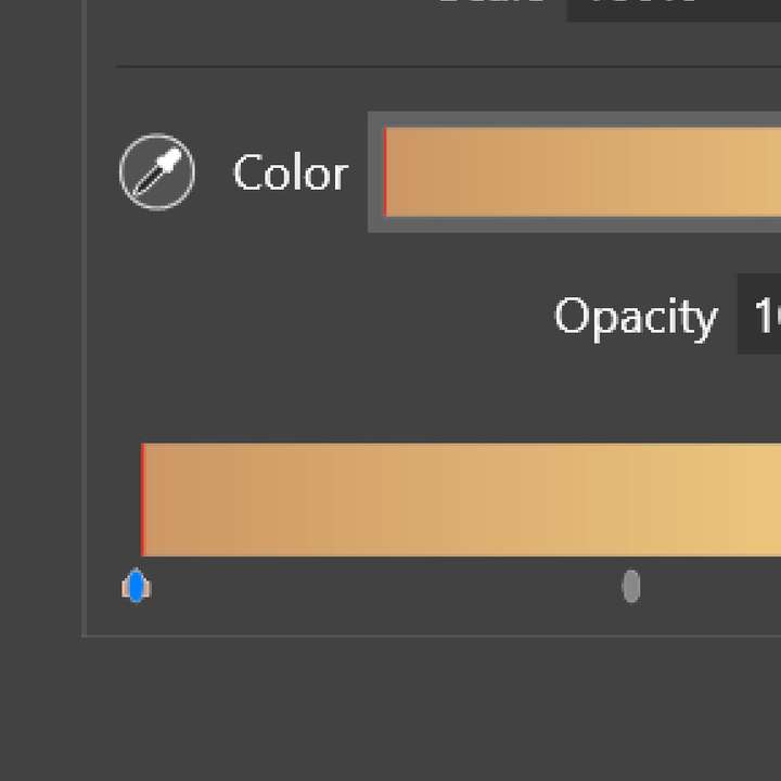

Gradient is unusable in this particular state. But I might've figured out at least part of what was happening. It's possible when I am making single/double clicks to activate the color flyout, it is creating swatches underneath the 1st swatch rather than allowing me to access the swatch node to pull up the Color picker. This seems to be the case as when I try to edit the 1st swatch, I'll occasionally see a sliver of the color I'm working with in the picker instead of the true 1st swatch, like I intend:
Closer up:
