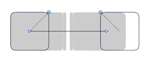

Offset between a cloned object and contour after blending
Just a test: a simple shape is copied into a clone (Transform object) and a blend is applied between these two objects.

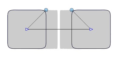

By moving the cloned object with the Node tool:
@Pat I opened a bug on this.

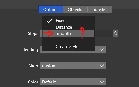

@VectorStyler There could also be a problem with the Smooth feature? I get nothing when selected.
@Pat This should create a smooth transition between different colors, or (if the colors match) a single intermediary object.
I tested this here and it seems to be working.If there is a file where the Smooth option is not working, please send it to me and I will try to replicate it.
@Pat This can be replicated, but I have to postpone it a bit. This is a general problem with the blend spine path, that when changed the end object frames are not fully positioned. This is an issue with any kind of shape, not just clones.
