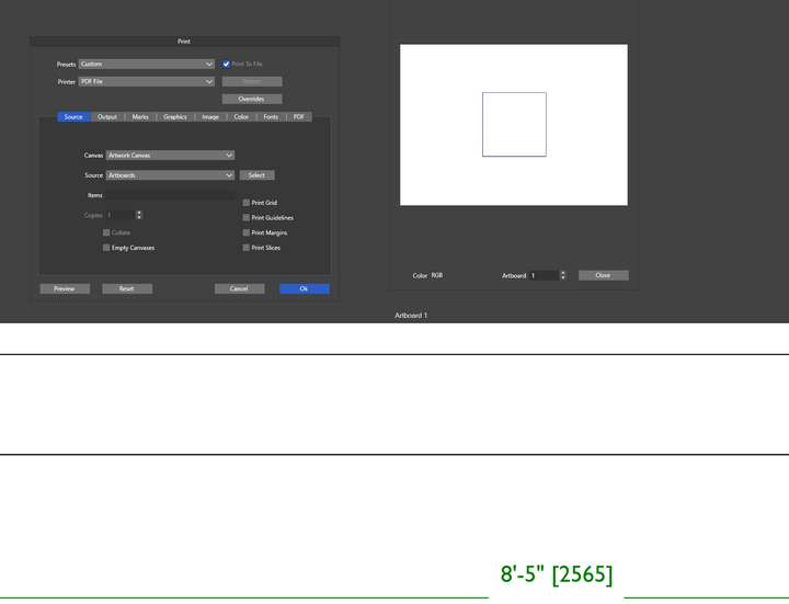

It recognises 2 artboards even though there is only one
so even if i print 'all' artboards.. it will only print artboard one - as there is only
.. but artboard '1' is a blank square (not created by me)!
I can;t share my screen (confidential client info)
But you can see that my artboard 1 is an A0 doc.. you can see a line and a green dimension line demonstrating..
however when i click on print artboard 1 is a blank square

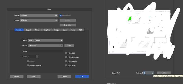

here is artboard '2' - which doesn't exist
sorry I had to scribble over actual file

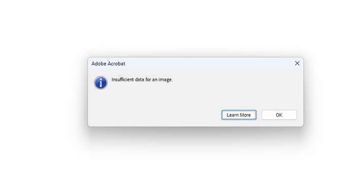

printing just gets me this
exporting the same

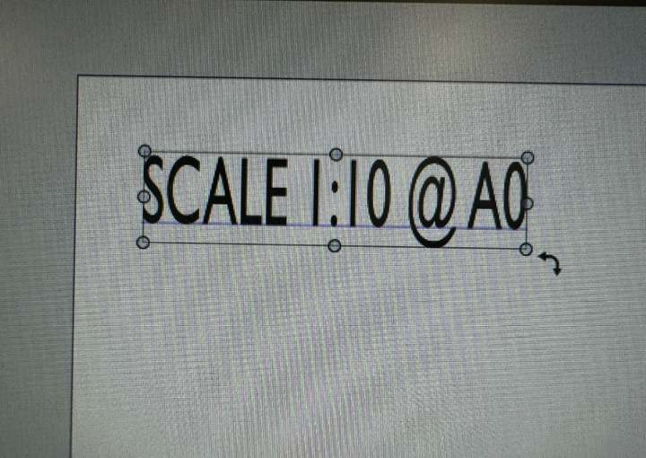

here you gobtw I have also found that the text re-sizing handles are broken..
I can't diagonally enlarge text (unless I do it back to front!)
Just checked.. it's on all new documents
If i create a document and click print it shows a small square as artboard one.. and the actual artboard 1 as artboard 2

edit - no there's stil something wrong. Although the 'additional artboard ' issue has gone I am getting errors on PDF print-out 'insifficient date ' etc as above

About the text resizing: I tested it here and it seems to be working.
When you hover with the mouse over the round resizing knob, what cursor is shown?This part seems to be again a workspace issue. Try resetting all to defaults.
@ambros The extra artboard issue can be replicated. Will be fixed ASAP.
@VectorStyler I discovered the extra artboard issue two days ago when I noticed an additional blank page in the exported PDF. I planned to submit this issue today.

@VectorStyler said in Will no longer print:
I just created a new doc and text box to check and it all works as it should.. that 'test document' i posted above is where I saw the strange behaviour.. it might be that the file is corrupted or something ?
@ambros said in Will no longer print:
Not sure, can you send me that file.
