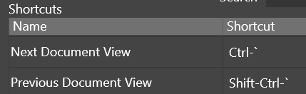

-The shortcut, or at least I suspect it is the shortcut, for Switch Document View doesn't appear to work. Or at least I can't tell what that specific set of shortcuts is meant to do. This one is the one I am trying in video (you can see keyboard feedback in the bottom left as I hit keys...):

@debraspicher said in Navigator View Presets are not working as expected:
The shortcut is to switch between different views created with the View -> New View command.
