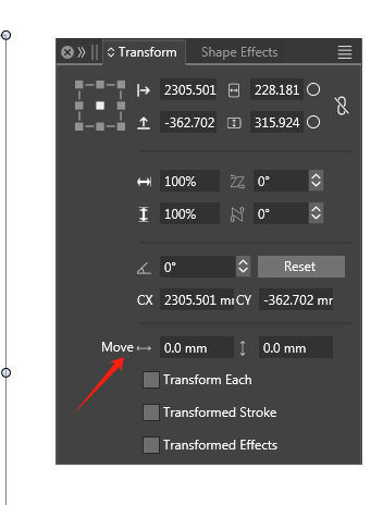

@VectorStyler Can a button be added to the coordinate panel to become a movement transformation panel? In this way, if certain parameters need to be moved, there is no need to perform addition and subtraction operations on the coordinate panel to get the result, nor do you need to open the movement transformation dialog box in the menu bar, which is more convenient.
@monsterfox There is a "Move Objects" option in the Transform panel menu, this will enable an additional field for moving.
 Two status displays have different functions, and the function of displacement disappears when the panel is pulled to the bottom. Please fix this problem.
