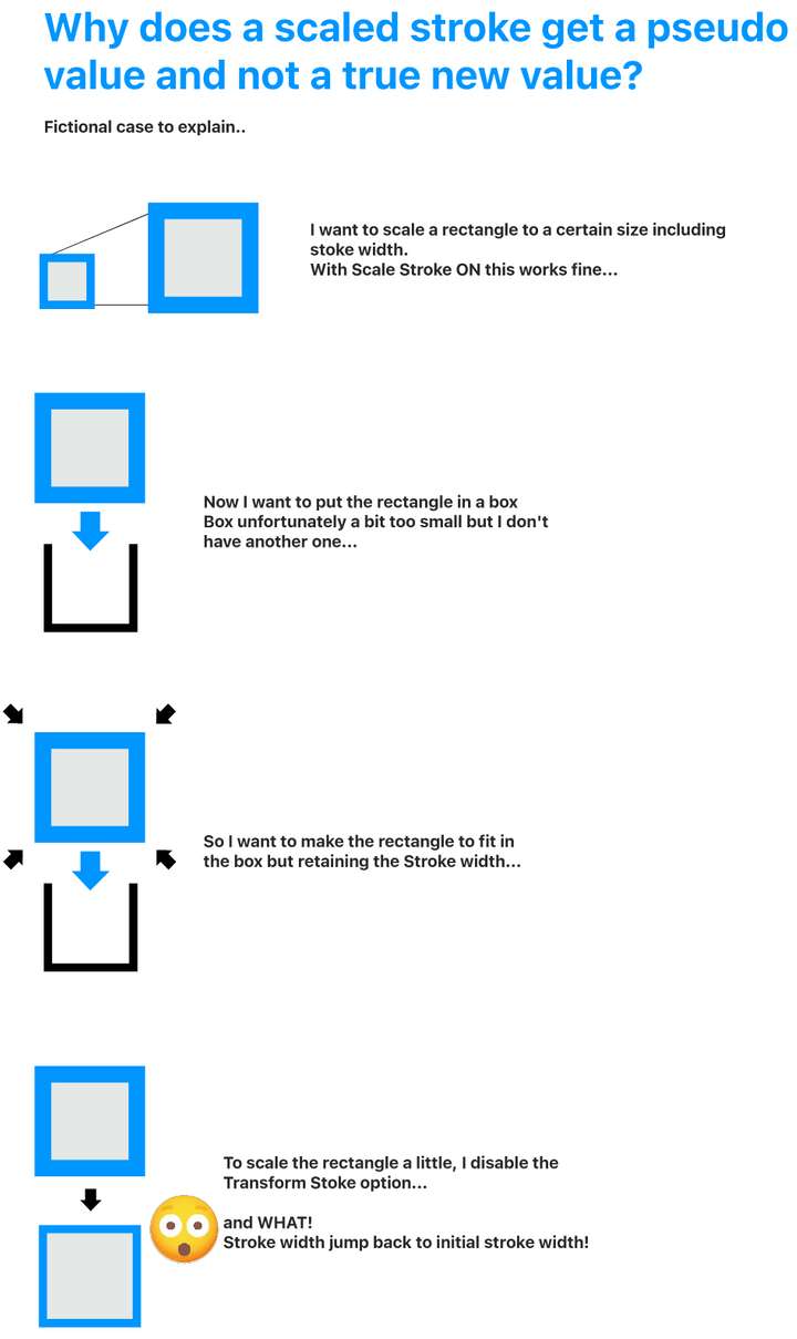

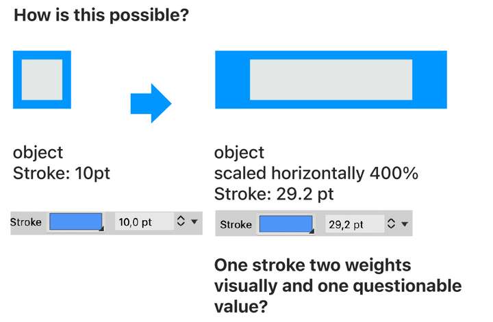

Scaled stroke gets pseudo value
Very inconvenient. With this method you are never sure about stroke widhts. Especially in complex composite documents where you have lost track how each part is constructed. Is this intended behavior?
@Ayo Yes, this is by design. The main reason for this is the nondestructive nature of transformations in VS.
The stroke width is not actually changed, but it is "transformed live" with the rest of the object. This can also result in some calligraphic strokes in case of stretching.

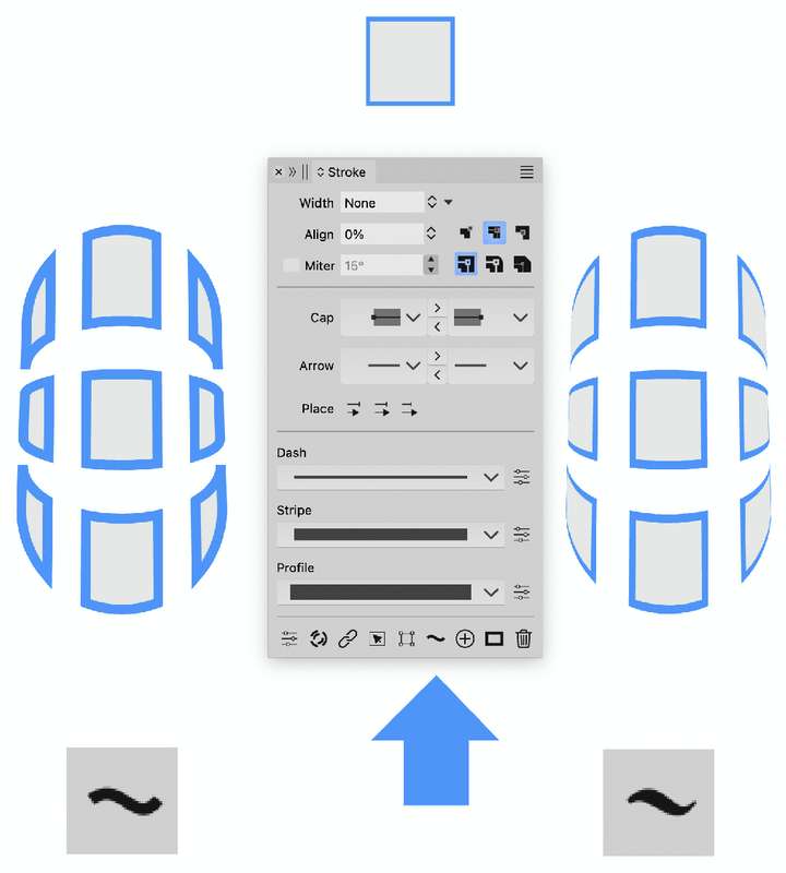

This is completely against my expectations and is very worrying. The stretching thing was indeed my next question (illustration see below) in the sense that what happens is confusing and inexplicable. But I'm starting to understand. Line becomes a kind of illustration in your approach in favor of effects probably. I wouldn't expect that from a true vector app.
yes, this is what happens and it is vectors. It is also possible to do this using effects like mesh or envelope, by enabling it with a button in the stroke panel.
@VectorStyler said in Scaled stroke gets pseudo value:
I can imagine this as a property possibility for effects, but should it also happen with basic drawing and transformations?
I'm concerned about composite artwork. Scaled as a total. Then decompsed into parts for example. Won't that be a mess of loosing object corresponding line weights?Do you mean this button, pointed below?
yes.
Gonna test it
Strange tooltip function description then for this button:
"Check to convert outline to paths when applying shape effects"Is that correct?
@Ayo said in Scaled stroke gets pseudo value:
Is that correct?
Yes, it is correct, could be formulated better. Basically the outline (stroke) is expanded into paths when shape effects are applied, but it is "live", meaning that it still behaves as a stroke.

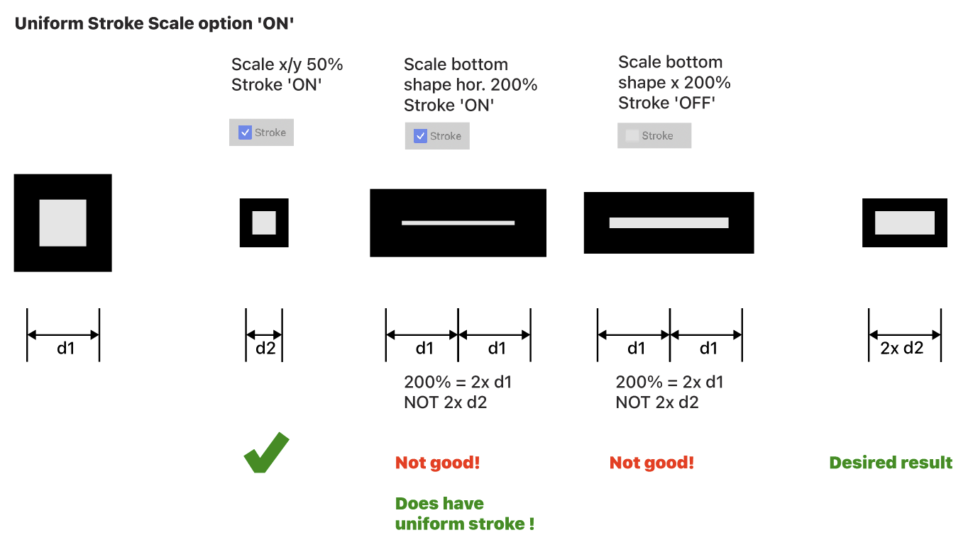

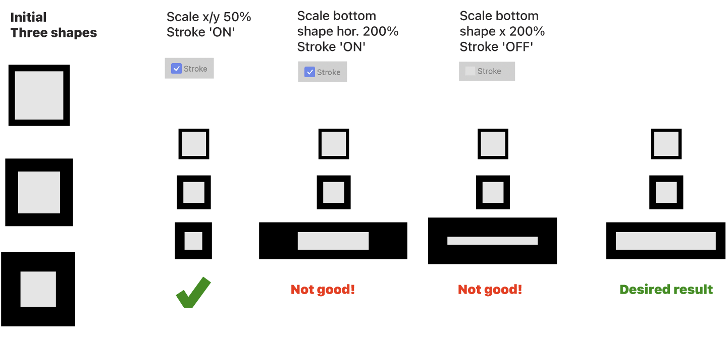

Yet again whining about the 'transform stroke' oddity. To understand it and have peace with it.Attached is a simplified example of a not unusual action where I do not achieve the desired result. Here, imagine a more complex illustration.
What would your workflow advice be without ending up in numerical actions/corrections.
@Ayo There is a Uniform Stroke Scale option in the Transform panel menu. The same option is also available document wide in the Document Setup view General tab, or as a Layer option
Sounds good and does work. But only a partial solution for initial problem.

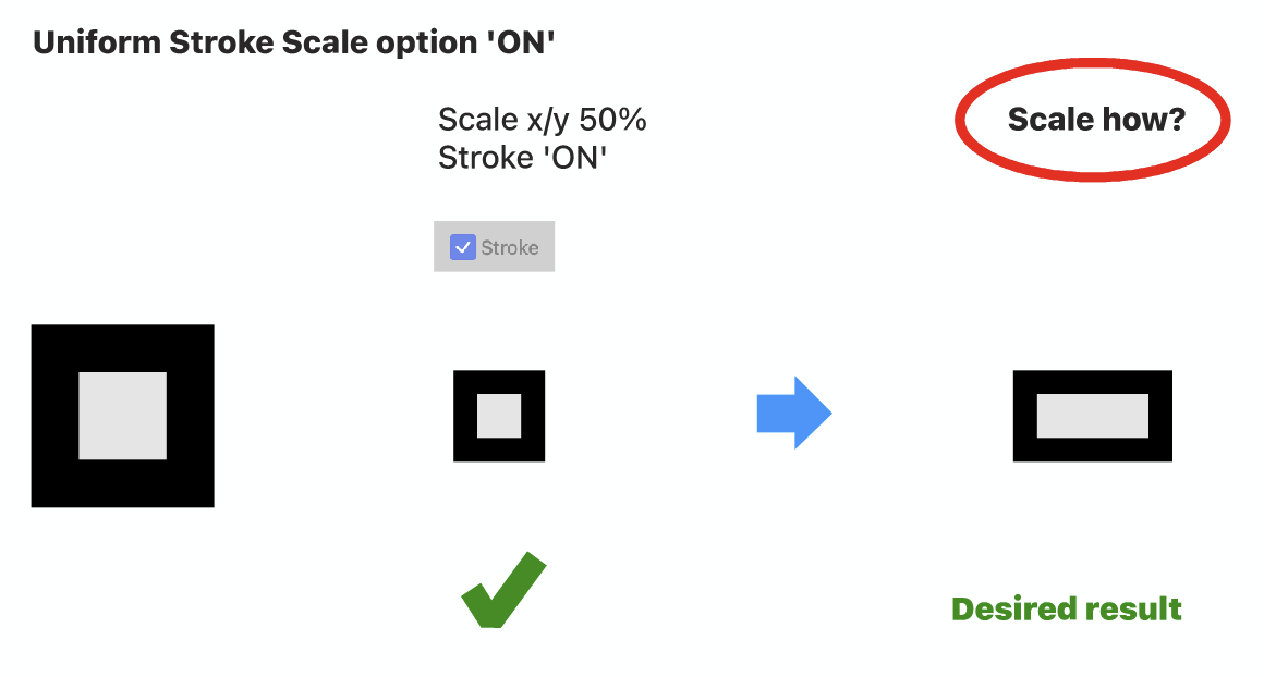

Uniform stroke scaling is solved by the Uniform Stroke Scale option in the Transform panel menu. I think scaling relative to the current size is then the issue.Visually summarized...
@Ayo You either 2x the horizontal scaling value, or reset the transform and then scale 200%

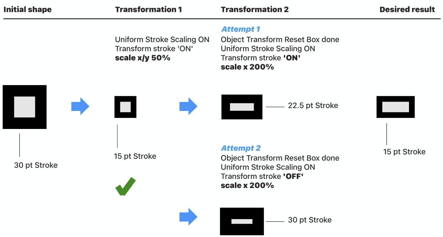

@VectorStyler Don't get it. Another try...
@Ayo I tried to replicate this, but I get different results at the Transformation 2 step.
For example, when Uniform Scale if off, the stroke width should not be uniform.
Can you save a file just after those steps, separate file for Attempt 1 and Attempt 2? and send me those files.
I just had a moment of clarity..
to summarize it in words:Step one, transform object and stroke property.
Step two, take the result of step one and transform the object, not the stroke property.Not too difficult...
Send you the files
