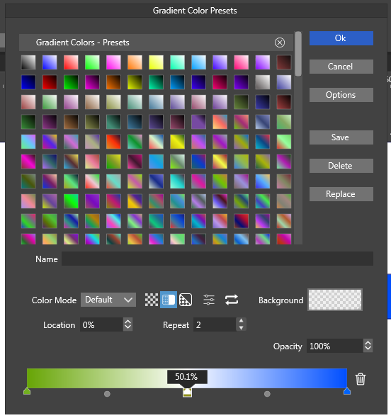

I have found certain peculiarities in the Gradient Color Presets menu.
If I click on a preset in the grid, the gradient at the bottom does not immediately update. I have to click on yet another preset item for the bottom gradient to update.
If I click Options → Create Empty Folder…, I can name a folder that is not immediately visible here. I have to go to the Preset Manager to even realise that I have created a folder.
I can hide the presets with no immediate way to restore it without going to the Presets panel. Not really a bug, but from a UI perspective this is really confusing.
Nothing seems to change if I modify the value in the Location attribute. It doesn't change the colour stop's position. The same applies to the gradient editor in Preset Manager.
