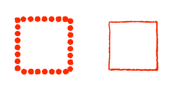

However when I try to use the Style Picker in Alternative Style Picker mode, it seems to only be applying the color of the stroke, not the brush. Additionally, it applies the color of the picked object to either the stroke or fill of the clicked object, depending on which is active in the Color Panel.

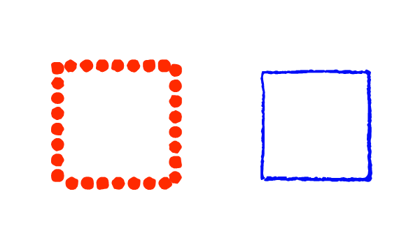

When I'm Default Style Picker mode it applies the brush and color as expected. Here I am attempting to apply the style of the left object onto the right.

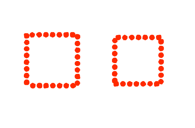

The two test objects:
The result in Alternate Style Picker Mode:
The Result in Default Style Picker Mode:

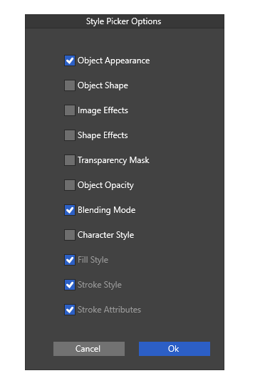

My style picker settings:

I'm a bit surprised by the settings in the yellow frame
Because you can only set these if "Object Appearance"
is deselectedSo they are inactive, but still selected?
@Subpath said in Style picker tool not working as epected on windows:
Because you can only set these if "Object Appearance" is deselected
the "Object Appearance" includes these.

@LoginError I replicated (at least parts) of this error, and a fix will be in the next build.
@VectorStyler said in Style picker tool not working as epected on windows:
In that case I would recommend placing them directly underneath the "Object Appearance" checkbox and perhaps indenting them to make the connection between the items a bit more clear?
@LoginError The alternate mode style picker tool issues should be fixed in build 1.2.038
