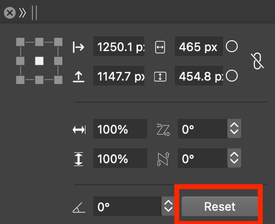

@jkwchui After each transform (well, not necessarily, but it's best) you need to reset the transform. So...
- scale > reset transform
- shear > reset transform
- rotate > reset transform
...and they will work correctly.
Opps...and that seems to be a bug. As you can see the Transform Panel is missing its title. It was grouped and minimized with another panel. Every time I tried to separate the panel, the Transform panel's title disappeared.
