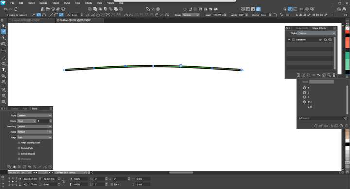

This is an unexpanded line. But whether I output SVG or paste it into AI, it will become an expanded form. And it also contains a clipping group. Please check what the problem is and fix it. Thank you.
@monsterfox The stroke is expanded because it has a width profile (small variation). If you open the stroke panel and click on the width profile editing button, you can see the width profile nodes.
The clipping is an export option ("Clipped Export" in the export view), that can be disabled.
