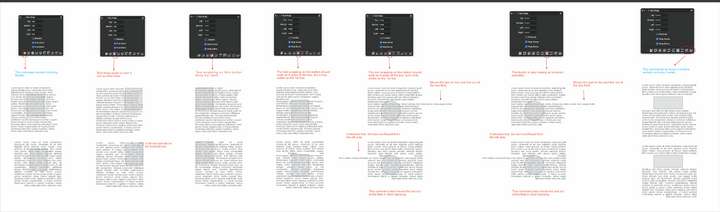

There are problems with the buttons under the text wrap palette. I have specified them in the attached document.
Sincerely yours.
Hakan Balcı0_1730876513571_Text Wrap Palette.vstyler

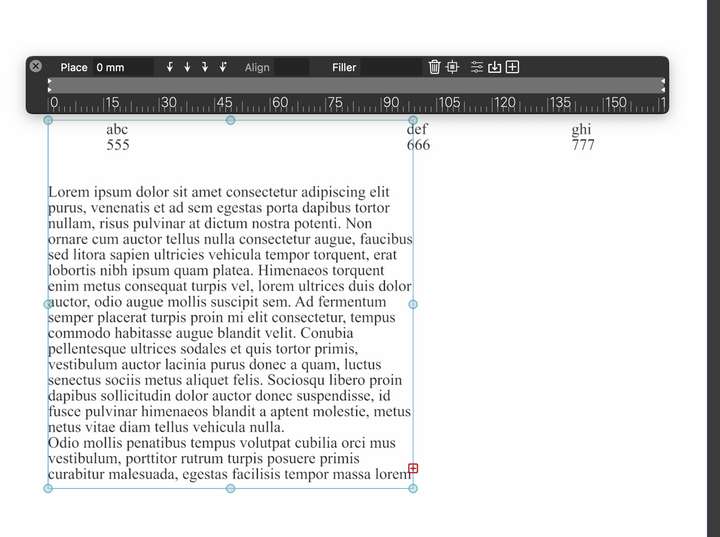

Also, in long tab stops, the text moves out of the text area.
@hbalcic said in A few suggestions for text wrapping:
Can you send me a file with that case also? Thanks!
BTW: these are very good reports, I will have these fixed in the next build.
I wrote the suggestion under the wrong topic, I apologise.
The file is attached.
0_1730899858017_Tab Stop Rev1.vstyler
@hbalcic This issue should be fixed in build 1.2.046

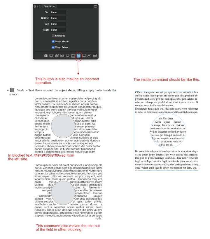

Inside command should be like this. it is explained differently in the manual.
0_1731069982556_Text Wrap Inside.vstyler
@hbalcic That wrapping mode is use to flow text around the shape but also inside the holes of the shape, when we have shapes with holes. This is not the case for a single circle.
