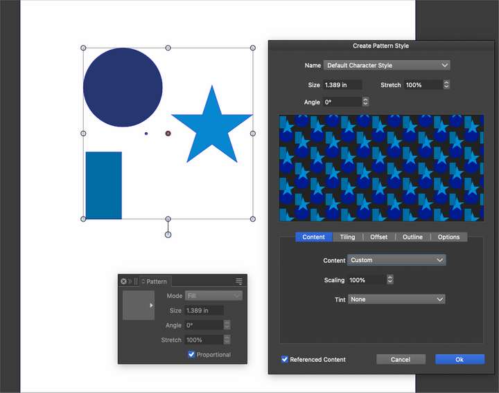

@VectorStyler, you replied, "it is possible to have real time preview while editing the pattern content.
This can be done by having the pattern content in the document and creating a pattern style (not preset) using the "Reference Content" mode enabled.Then editing the content object previews all uses of the pattern."
I tried this here but I'm not seeing how it creates the realtime preview while allowing the for the pattern objects to be easily adjusted:

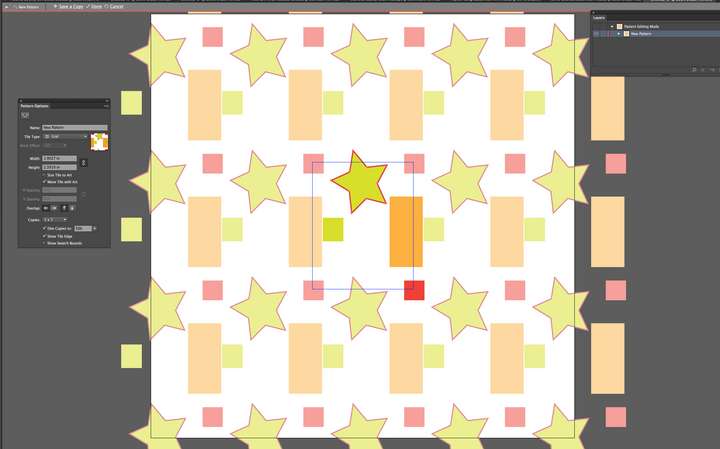

In the video I created several independent shapes and then turned on the pattern panel and then edited the pattern. it immediately created a repeating low opacity preview of the pattern and shows the bounding box of what the original pattern would be. I am able to scale, rotate, style the shapes in any way I choose and the result updates in real time. One of the bigger benefits in this is the ability for the user to create a unique spacing layout that repeats perfectly- as opposed to only being able to create a standard repeat like with repeater
Lastly, here is a video from a designer named Von Glitschka
He goes over in more detail how he uses the illustrator pattern panelIn my humble opinion, adding these features to the VS pattern panel would be a valuable addition and would be expected by users switching over to VS. It would add to the user-friendly aspect and help many of us who want to create seamless patterns in real time without having to guess

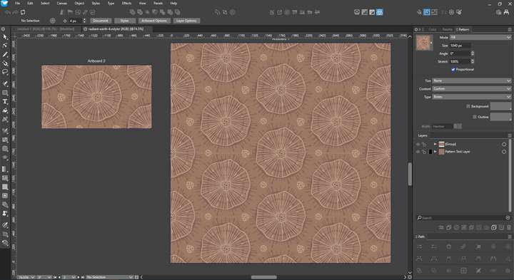

I have made things 'work' by creating 2 artboards, setting up a 'referenced' pattern on the small one (representing the completed tile) and displaying the seamless use on a large artboard. It is a bit cumbersome. I follows largely the technique I have been using for many years in Inkscape, and what @Subpath documented for VS.

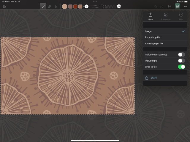

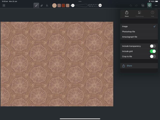

@VectorStyler Seamless pattern creation (for my purpose as surface pattern designer) opens up a huge industry with potentially a lot of users. The output required is a square (rectangle) tile, which includes the applied repeat as a whole (a square no matter if the pattern orignates from a hexagonal, half brick or whatever repeat). Then we need to export the design in several colourways (limited palette). The design I was working on yesterday was a recreation of a hand drawn pattern on a hex basis, which I had exported and now had a desire for to make it a vector.
I hand drew this in Amaziograph (which is amazing for this purpose) and which always yields a repeatable pattern. You do select a grid and set the size to work on initially, which means the ratios for height/width are knowns.
I traced it (in Inkscape, as I know my way around there better) and then made the repeat pattern there. Then I tried to do the same thing in VS, where I ran into some issues (which may have had to do with the transition of the svg from Inkscape to VS due to internal transformations but I was not able to figure out what was the cause).VS shines from this point forward for this particular user group as the replace colors / replace color from palette is THE single most wanted feature for surface pattern designers (for textiles). We often work in a limited palette (8-12 colours, can be less, can be more) and cycling through this palette to find the best styles is brilliant. Such functionality is only readily available in that big commercial brother that we try to avoid.
