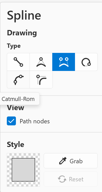

This is, like I've said in my earlier comment, a simple combination arc spline and polygonal segments. This is a useful addition, but does not warrant a separate tool. It is a pen tool mode. See Boxy SVG, which, of all the software out there, correctly categories it as one of the Splines. You have Quad Bezier, Cubic Bezier, Basis, Polygonal. The single most interesting mode of pen tool is catmull rom, which is used extensively in animation. Again, too out of depth to explain the mathematics of this.
In case you didn't realise, Catmull Rom is implemented in a modified form within Affinity Designer. It's the smart pen mode.

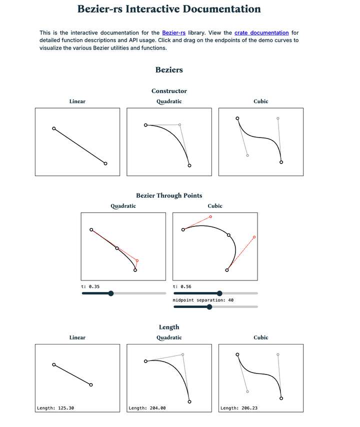

@Daniel @VectorStyler I found this website called, "Bezier-rs Interactive Documentation" today as part of the fast developing online open source graphite app. I love that it's interactive and explains through its ability to interact with. I thought you might appreciate it. Graphite has a lot of nice features that are worth checking out.
