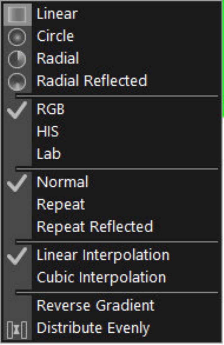

Fourth degree of Direct: Provide a context menu that contains a simple set of options to alter the gradient. Like so. All of these steps together makes for a much more convenient experience.

The gradient menu comes up upon right clicking the gradient line, and it is supremely easy to use. This isn't in Xara, but in PL.
