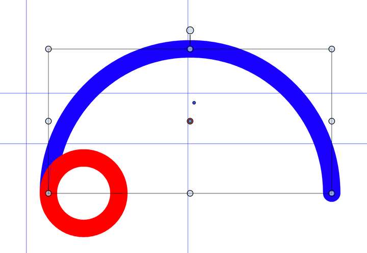

I only need very basic geometric constructions but with perfect precision and magnetism.
In this case what happened was that the stroke transform was enabled and therefore the stroke was transformed.
There is no other way around this then to disable stroke transformation (Stroke panel menu for selected objects, or Document Setup for all). But then the stroke width will not be scaled / transformed with the object.
What setting to disable stroke transformation in Document Setup ?
The transformations are systematically stored by default virtually, as styles effects, with no other option?
If this is the case, is it possible to definitively apply a transformation, and make it disappear, in "Shape Effects", as "reset" in "Transform"?

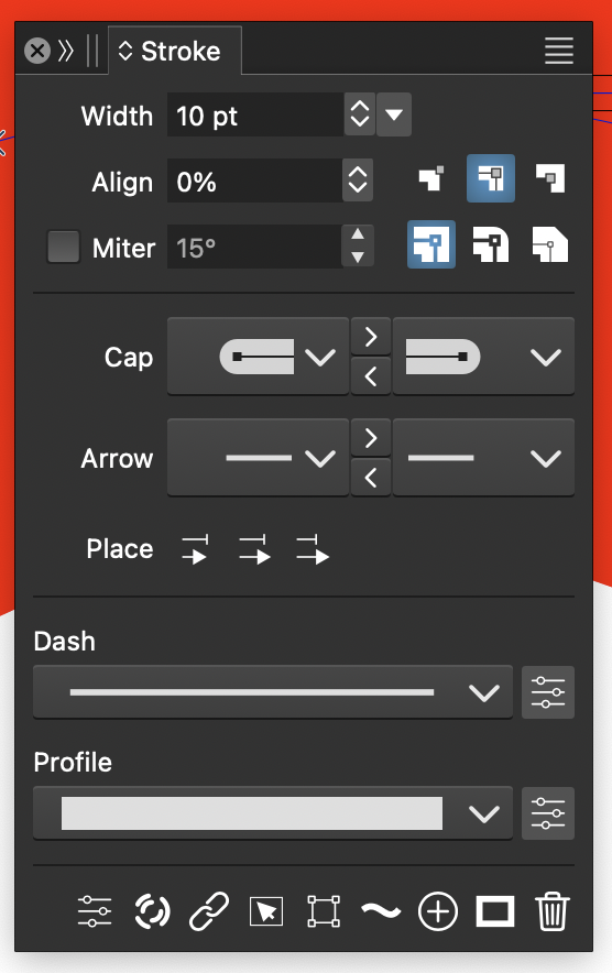

In this case I get 2 objects of visually different thickness, but both indicated at 10pt. And I don't see how to know which one is good, and modify the other.
@fdarnel said in Same width, visual difference:
They are already curves, they must be converted a second time?
No need to convert the second time, they are curves if the group was convered.
This is a bug I mentioned in a different post: the stroke widths may be shown wrong in the UI, if the objects still have style transforms. This I will fix soon.
