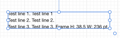

Brand X Text Frame

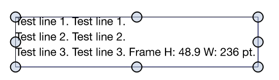

VectorStyler Text Frame
I need to be able to stack text frames so the height of each text frame is important. When I do this using VectorStyler the text frame height is causing a problem.
Not sure if this is a bug or I have an incorrect setting.
The test text frame settings: inset - 0 pt., space after line 1 and 2 - 4 pt., and space after line 3 - 0 pt.
A test text frame with these settings has a space (gap) below the last line when I fit the size of the text content using the Text -> Fit Text Frame command. If I manually reduce the height of the text frame, the linking icon (bottom right) color changes to red which means to me that the text frame is over flowing.
What could be causing this space (gap)? Is it a bug?
I did a test using Brand X and VectorStyler apps. The Brand X app text frame did not have any space (gap) at the bottom and the height was 10.4 points smaller than the VectorStyler text frame.
