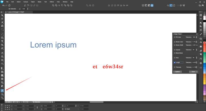

Using this tool, my original intention was to replace the font attributes, but I didn't expect the text to be replaced as well.
Perhaps this matter was accidentally missed? @VectorStyler

@monsterfox What are the tool options (shown when double clicking the tool).
@monsterfox I could not replicate this issue here.
@VectorStyler I've identified the issue - this checkbox cannot be selected
@monsterfox The Object Shape checkbox means that the shape is copied.
If the VS point text (text shape) the text itself is the "shape" of the object. This allows things like using editable text for clipping.
