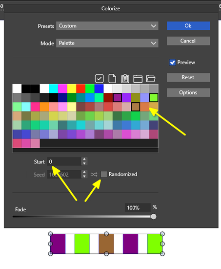

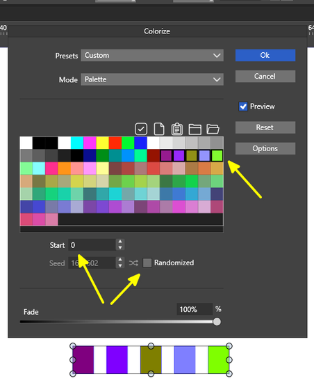

First option, work with the Shift key.
Select a color with the mouse, hold down the Shift key and select
another color. All colors between that two colors will be selected.
Second option, work with the CTRL key.
Hold down the CTRL key while selecting a few colors from the color palette.

Here a Shift Key Screenshot
.and here a CTRL Key Screenshot
