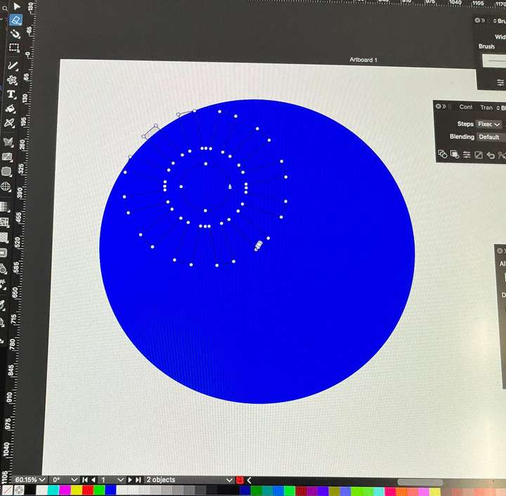

Also, when I use the eraser tool I get a large blue shape appear on the screen. The eraser works ok when I move it along a path and doesn't erase everything under the blue. I had to take a photo of screen as blue shape only appears when the eraser is active, ie when pen is pushing down.

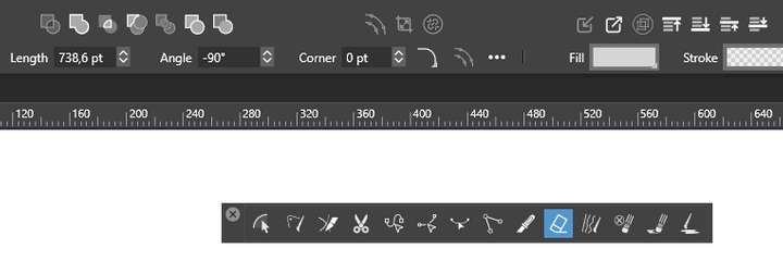

What i spotted from your Image, you dont have Eraser Tool selected.
This is the "Path Eraser Tool"Here a Picture
Thats the "Eraser Tool".

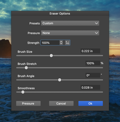

Just double click this Tool icon to get the Eraser Options

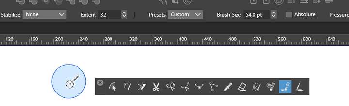

It seems a bit strange to me that the Brush Size
of the "Path Eraser Tool" could only be changed by
double Click on the "Eraser Tool"If i double click on the "Path Eraser Tool" the
Path Panel appears. Also there is no Brush size
Preview, only the "Eraser Tool" and the "Node Remover Tool"
shows a Brush Size Preview.

It seems the initial default brush size was set to 800px, hence the large blue preview.

@Boldline said in Change the shape of the eraser tool:
If I want to change the shape of the eraser to a circle or square, how do I do that?
When the Eraser tool is active, the context panel contains this option.
@Subpath said in Change the shape of the eraser tool:
double Click on the "Eraser Tool"This option should also be in the context panel.
Brush Size for the "Path Eraser Tool" is not shown
in the Context Panel when the Path Eraser Tool is selected.The Brush Size for the Eraser Tools will only shown
when the " Eraser Tool " is selected. Which seems
a bit confusing.See Pictures
Yes, I was thinking of a different tool. I will add this.
