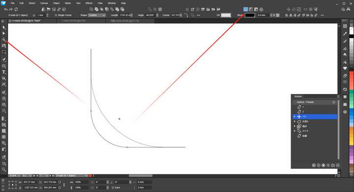

When using the rounded corner tool in Outline mode, ghosting was found.
@monsterfox said in Four errors:
I opened a bug on this.
