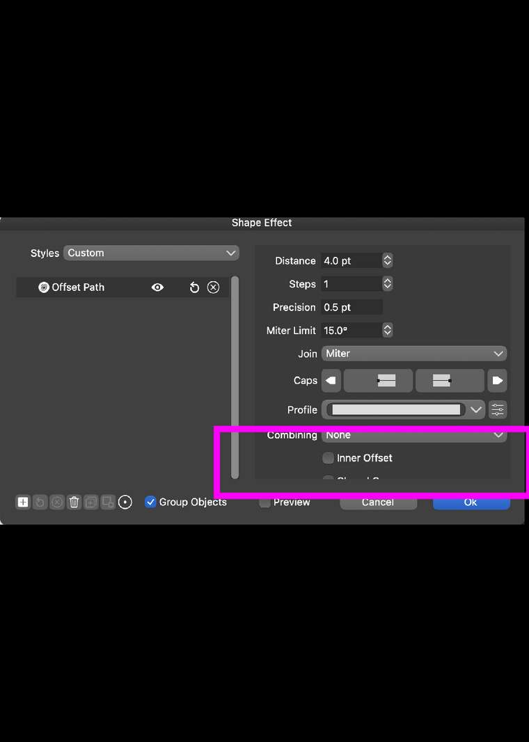

Not really a bug, but, you may want to adjust this:
I noticed that when opening the Offset Path Effect Panel (Effects>Outline>Offset Path) the first time (or after Workspace->Restore-Default), it does not reveal the entire Panel vertically (cuts off the items listed below the Inner Offset) like this:
@Vector-Rock Most of these features are available now in 1.1.002 (beta)
