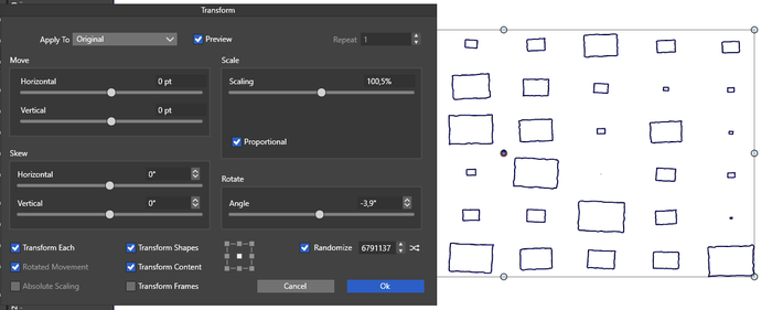

Scaling objects with " For Each " in the Transform panel works way
too hefty in my eyes. It would be nice if a user could specify
a minimum and maximum scaling.The size difference is too much for 100,5%.
But could also be a bug, dont know.Here a approach of mine, scaling is 100,5%
@Subpath I opened a bug on this and will try to find a solution.
yes I observed the same and found it excessive too. I think the scaling randomization picks a random value between 0 and 100.5%, which yields to extreme variation.
Offset and rotation being in absolute values - not percent, the effect is easier to adjust precisely
With only one cursor for scaling, maybe the variation in that case should be +/- 0.5% (99.5% to 100.5%) to remain more subtle.
