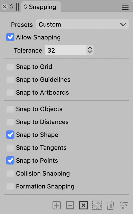

Why when I enable snapping the lines are forced to orthogonal direction, even though I didn't enable the option?

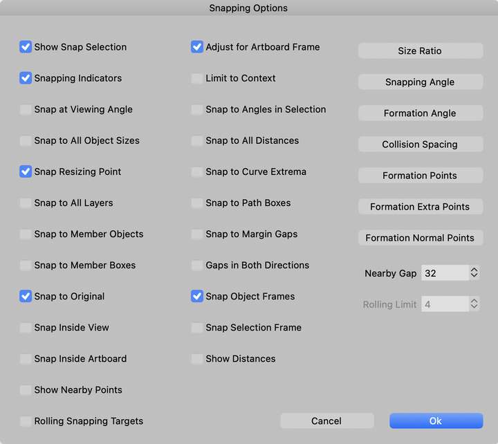

Which snapping option was enabled?

@Fertuffo I set the same options, but I still could not replicate it, here is how I have it: https://share.cleanshot.com/m2mG79yj

@Fertuffo if the "Allow Snapping" (in Snapping panel) is disabled, then is there an issue?
@VectorStyler said in Snapping forces orthogonal:
no issues when "Allow snapping" is disabled.
