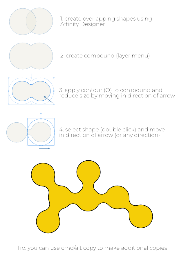

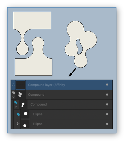

@monsterfox This reminds me of the effect/trick you can achieve using Compound layers and contour tool in Affinity Designer. Afraid I don't know VectorStyler well enough if similar is possible.

@monsterfox Here's the method I used...
@Jono Thank you. Your method uses circles to create a blending effect. It's simple, but requires stitching and is a bit tedious.
