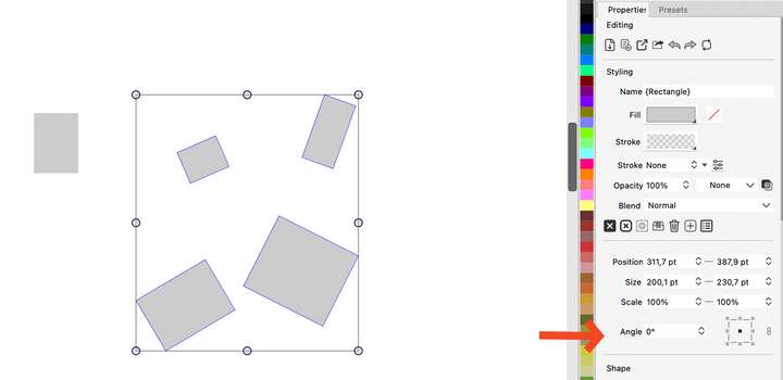

I have multiple shapes with random rotation. I want to select some of them and reset their individual rotation back to 0°.
If I multi-select them, the properties panel shows 0° (which, logically, is the rotation for the selection box of the shapes) and doesn't allow to reset individual shape rotation to a fixed common value (of say 0°)
I wonder if there is a way in VS to impose a common set of transformation parameters to multiple objects (like all have a rotation of 0° or a width of 10pt).
Affinity has a 'transform objects separately' option, which works well for size, but not for rotation
