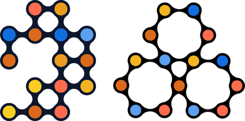

Meatballs created in VectorStyler, will differ from those created in Affinity Designer.
Affinity Designer recognizes outlines without color information, while VectorStyler
only recognizes them with color information. This leads to results like these.

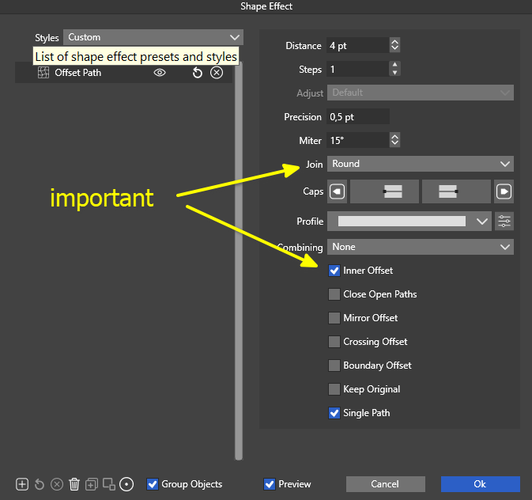

.However, using the "Offset Path" Shape effect in VectorStyler, offers a way
to create outlines without color information.
( Menu > Effects > Outline > Offset Path )

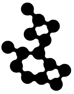

The minimal steps needed
Note:
Do the Offset Path Shape Effect always at first.
Create two circles and let them overlapping a bit.
Select both circles and apply the Offset Path Shape Effect to them.
( Menu > Effects > Outline > Offset Path )Here my Settings
Apply the Effect.
The Setting can be change later if needet.
While everthing is still selected apply a Composite Shape Union on them.
( Menu > Object > Composite Shape > Union )Experiment a bit with Settings on simple Designs first to get a feeling
which Settings fit best to your needs

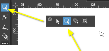

Copying and moving MetaballsBecause these Shapes are connected with Composite Shape Union using
the Transform Tool will move the entire design.Use this Tools instead for selecting and moving Metaballs.
Copying Metaballs is also special. Clipoard copy paste will not work.
This will destroy the Composite Connection. Your best bet is using
the Alt key copy Feature.Selection Frame also dont work with the Tool i mentioned for moving
and selecting. But hold Shift and Pick the Metaballs work.For copying Metaballs. Hold Shift and pick the ones you like to copy
with the Tool i mentioned above. Hold the Alt Key and move them
with also with that Tool.Here a video
