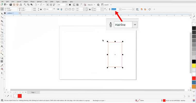

It’s a minor thing, but any chance VectorStyler could display the word Hairline, spelled out, in Stroke Panel Entry Field instead of 0.0 pt when a Hairline value is set?
I personally prefer that, plus it would make it consistent with how VectorStyler already shows it in the Stroke drop-down menu.
CorelDRAW does it that way and looks like this:

@fde101
Yep, you nailed it.
It's the industry standard nomenclature, that's why I prefer/suggest it be used in VectorStyler.
