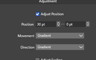

Using Gradient with Movement and Direction with Adjust Position.
Perhaps I may have a wrong thinking of what's possible with a
gradient in this case. Because using a gradient didn't work as expected.I'm using a linear gradient here in both Movement and Direction

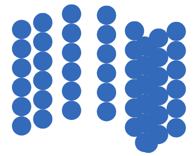

and expect the shapes to move linearly. But they behave
unpredictably and certainly not linearly.

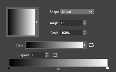

This is the Gradient i use in both Movement and Direction.
The Value i used

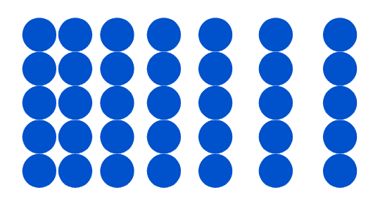

The Result
I expected something in this direction

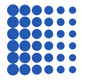

shape effects in combination with the Repeater.In this case, I was and still am more surprised by the behavior of the Repeater
when using linear gradients with "Adjust Position." And I would never have
expected such a result when using a linear gradient. (see above post)"Adjust Scale" with a linear gradient works as expected.
