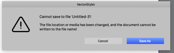

  • After updating to 1.2.076, I can no longer save files.
    The following alert appears. (License 0)
    The document content is simple, such as a single rectangle.
    I can save files without any problems with 1.2.034 on the same machine.
    I have performed maintenance on my Mac using TechTools, etc.
  • administrators
    @861475_VctSt Most likely something broke with the update.
    Remove VectorStyler completely also the settings folder (Help -> Reveal Workspace)
    Download and install again.
    What happens immediately after selecting the Save command for a new file? Did it show the Save panel?
    And what folder was selected?
  • @VectorStyler
    Thanks.
    As you pointed out, there seemed to be a problem during the update. I deleted all VS-related data, did a clean install, and the problem was solved.
