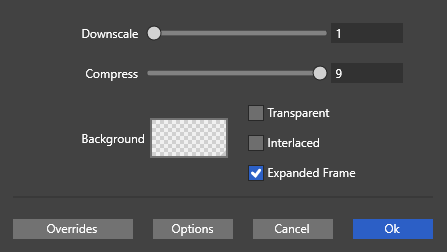

here a pic with .PNG format
What i dont understand when i export a image,
in this case a .PNG file, that the little Background Window
shows a Transparent Background.But the exported File has a white Background, only
because the Transparent Flag is not set. I would say
the little Background Window is misleading.

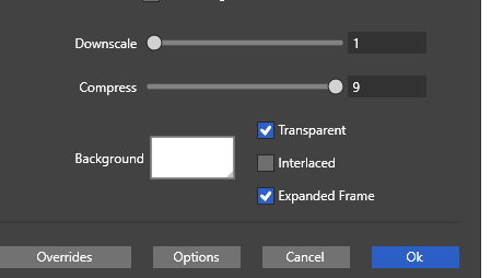

@Subpath @VectorStyler OK thank you. that makes more sense. Maybe I was confused because the option for transparent was there automatically when i started editing the settings under bmp.
