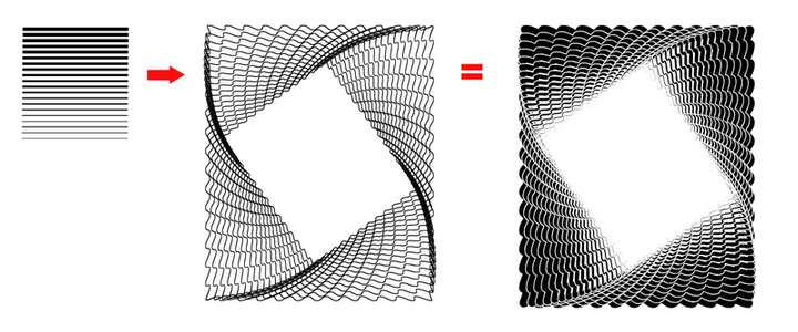

Using Blend wouldn't work in all cases.Sometimes you have multiple objects, in my case, multiple paths,
where you want to assign a slightly different style to each path.At the moment, you have to do this for each individual path by hand.
That's why I thought a style picker that works with multiple objects
would be helpful.In terms of functionality, you could perhaps group the paths/shapes
you want to transfer and group also the paths/shapes that should
receive the styles, and then use the style picker to select the group
whose style you want to transfer.Here a picture to illustrat this.
@Subpath I added this to the backlog for the Style Picker.
This feature exists for object styling, but not for the Style Picker.
- create a group from the first picture (the lines).
 - in Object Options, give a name, and in Role select "Object Style"
 - also in Role select More Roles and check "Group Styling", then confirm the Object Options
 - now the Styles panel will have a style with the above name (Object Reference -> Object Style -> <name>)
 - make a group of the second picture
 - apply the object style to the group.
