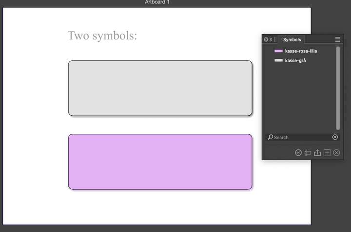

When I 2x click symbol in list to replace the selected one on artboard an unwanted offset occur. A bug or something with object/symbol design?
0_1761380482474_offset-issue.vstyler

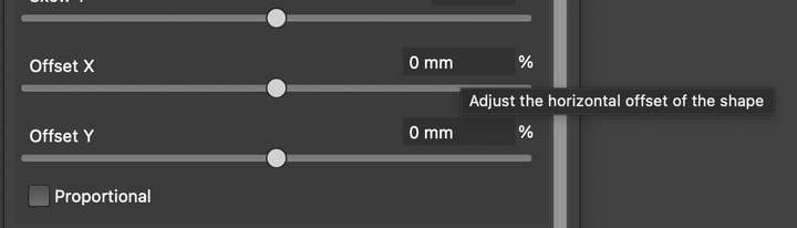

The offset is in the symbol,
Where do you see this? I cant find it in shape-effects anywhere in the group if I detach the symbol.
@Raaskot This offset is not editable. It can be reset to the center of the group with the Transform panel menu Reset Center. If you reset the center before creating the symbol, then it should position to center.
