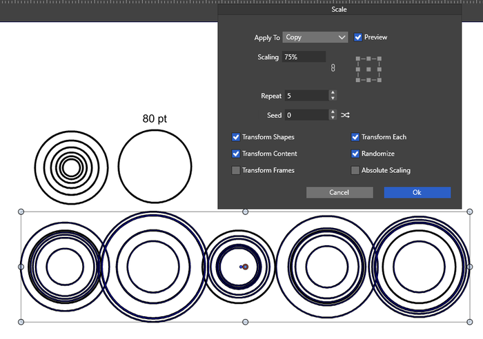

  • When I scale an object by 75%, in this case a circle, I expect the
    copies to be smaller than the original.
    However, this isn't the case when I use the random function. To
    my surprise, some copies are even larger.
    It would be nice if it worked as expected.
    @Subpath Randomization selects a +/- scaling around100% in this case.
    I will check if this is possible to change.

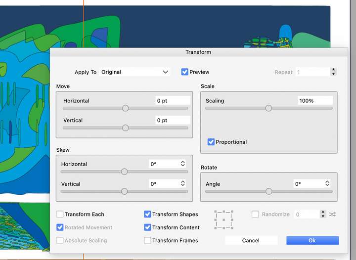

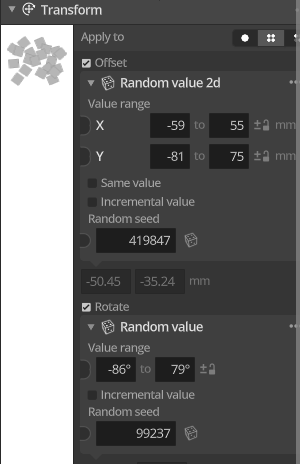

  • @VectorStyler I wanted to raise a feature request on this and the randomization in transform panel.
    I also have frequent need for asymetric randomization, meaning that if I select 75% scaling, I would want the objects to be scaled randomly between 75% and 100%. If I choose 200%, I expect objects to grow from 100% to 200%.
    Same goes for x, y offset where the randomization gives same results in positive or negative offset. That's not always desirable when you want to shift copies to one side randomly to create a trail
    There can also be a need for scaling symetrically around 100% (the +/- scaling), which is another use case.
    With only one slider, it is not easy to accomodate both needs. Maybe you need 2 sliders (min, max), or better, a checkbox to choose the mode to use
    It would be for all transform parameters, not just scale.
    Also, a reset button for the transform panel would be welcome as there are a lot of parameters

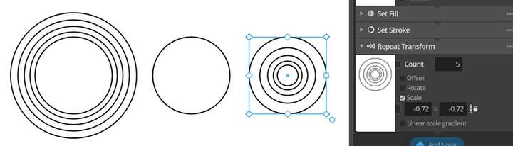

    Paragraphic's repeat transform is not scaling randomly. When you specify that scale a value less than 1 will give you smaller circles each time, while a value greater than 1 will give you larger ones each time.
    You need to explicitly tell Paragraphic to use randomness, and when you do, it allows you to specify a seed and a min/max range within which to randomly modify the values it is being applied to:

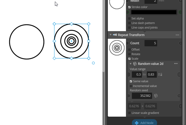

    You can, of course, also generate copies randomly by using the "Randomize 2D" input node. Here too, the size of the original object will not be exceeded as long as you keep the Value Range below or at a maximum of 1.
    If you want to like to have random values ​​within a larger range,
    then you can also enter values ​​greater than 1.
