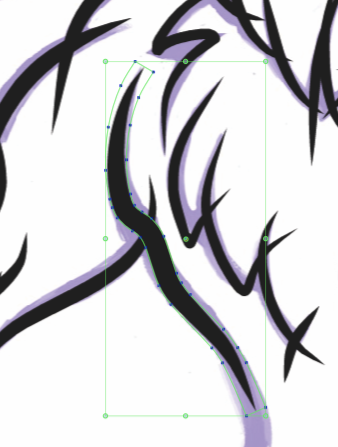

    I trace over my sketch with a pen or brush tool - then expand strokes (under the styles menu) I understand if I had any shapes, I'd need to convert those to curves. I feel like I need to do this step several times - expanding the strokes...
    Then I select all and hit the divide option from the boolean operations. I try to use break apart and ungroup all, but things still seem to be connected as compound paths and I don't know how to break them apart so I can delete the overlap parts.

    @Boldline The process is complicated a but when using Brushes. The Expand Stroke will result in an object with the artistic brush content and a bend effect on it. This is why a convert to curve is needed to get to the filled shapes.
    For the type of drawing in the example, the Pen tool will do, with the Pressure mode (in the context panel) set to Selected to use the current width profile selected in the Stroke panel.
    The pen tool will result in regular strokes (not artistic brush paints), and expanding these results in filled shapes.

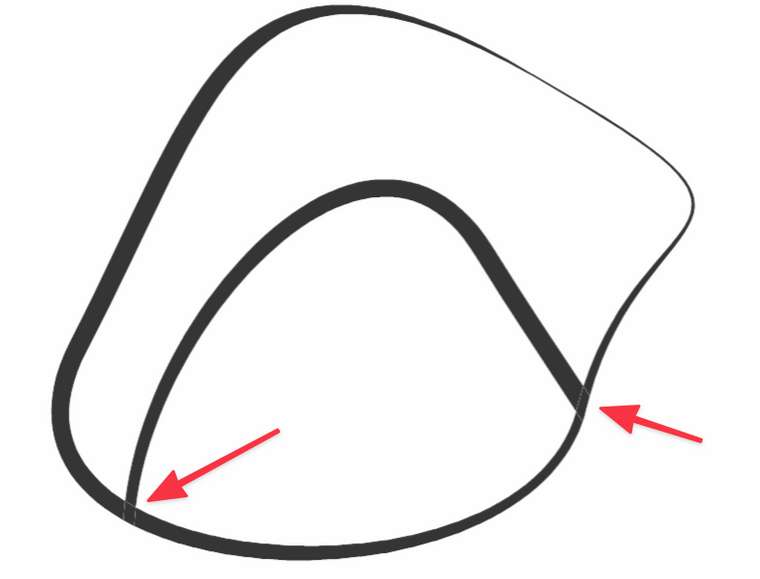

  • @vectoradmin Thanks for explaining. i understand about the pressure setting overriding the default settings of a brush and a bend effect being necessary to create that effect. I can also understand using a plain stroke with the setting set to selected - and picking a taper option from the width profile in the stroke panel. I was able to do the latter and it worked fine in terms of expanding - clean boolean divide and then combine. (though I can still see a faint outline of the pieces - see attached image below this paragraph) Could you explain the proper order of steps you'd use to do this? Draw the strokes - expand stoke, convert to curves, divide, combine? Am I missing anything else you'd do? (anyone can chime in on this)
