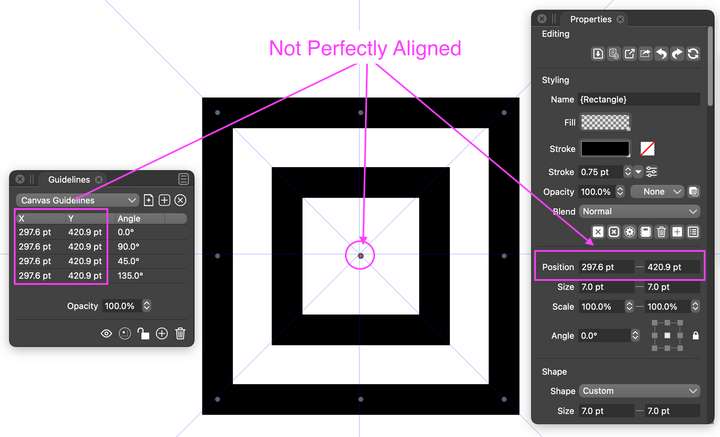

I created a Perfect Square and the Center of it is off slightly and not perfectly aligned with Guidelines set to the exact same location.
In my Example, the Guidelines Panel X and Y coordinates are the exact same value as the Square Center Position Coordinates as shown in the Properties Panel, yet the intersection of the Guides and the Center of the Square are not Perfectly aligned.
This can clearly be seen when using High Zoom magnification.
Maybe there is some kind of "rounding errors" ?
I am sending you the file for examination to see if you can determine why there is not perfect alignment so you can fix it.
FYI, I also tried another example with a perfect Circle. This also did not align perfectly.

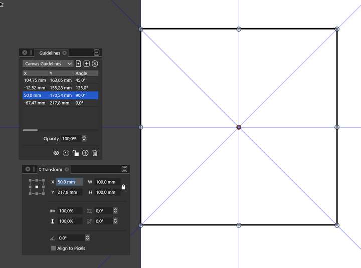

I can't reproduce the error.
Maybe two decimal places would solve the problem? What about other units

The issue is with the precision of displaying the number in the UI. The actual rectangle X position is 297.638 pt.The precision of numbers can be set in Preferences -> Number Editors -> Point Decimals (when pt is used).
Typing 297.6 pt into the field and confirming with enter, will move the rectangle to the proper position.

Adjusting the Preferences by increasing the number of decimal places did provide accurate alignment.
