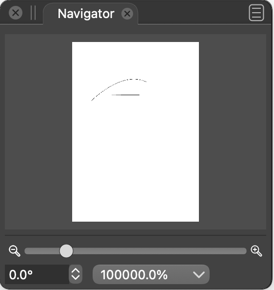

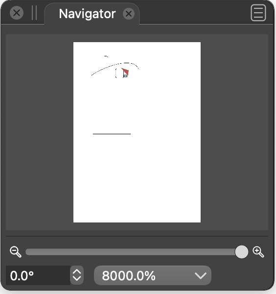

There are a lot of Problems that seem to be associated with with Zooming in General, the Zoom View Tool, and Zooming within the Navigator Panel.
These are in addition to the other Bugs posted recently (and files sent to you), related to the Navigator Panel specifically.
Below are some things I have observed.
Zoom Value problems:
Slider Bar Handle Position not Congruent with Value in the Numerical Entry Field.- Zoom Slider Bar sometimes is maxed out at the far right position but Value in the Numerical Value in Entry Field is only 8,000%.
Example:
.- Value of Entry Field can be at 100,000%, but the Slider Bar Ball Handle is less than half way to the right.
Example:
- Even on some occasions when the Slider Bar is at the far right Maximum, using the Zoom View Tool from the Toolbox, you can still Zoom in farther. Often times you can Zoom Click and Drag several more times with the Zoom View Tool, and while you are actual getting closer up, the value still shows 100,000% at each of those intervals.

@Vector-Rock The zoom slider will have a smaller limit as the maximum zoom, as it would be hard to control a value that large with a slider.
But the bug here is that the slider position is not always updated when zooming in. This will be fixed.About the other issues. At what zoom level these occur?
