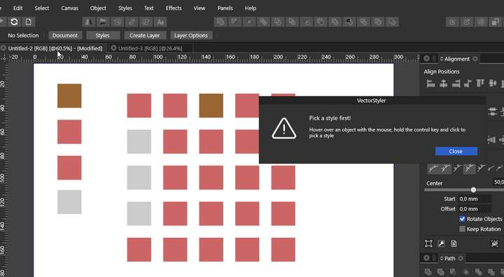

During testing, this window appeared to me. For the first time since using VS.
More of these explanatory tips could be useful. Is there still a lot of this type. I guess it's time consuming, especially now that a lot of things are still changing.
@encart that's cool! Reminds me a little of what Affinity does by giving you hints at the bottom of the screen based on what tool you have selected at that moment
@Boldline Yes, their solution works great. Overall, when it comes to ergonomics, Affinity is in my opinion a lot nicer than the Illustrator. When I think of something, I check how they solved it, because it usually works more intuitively than in the Adobe product.
